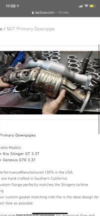

Hi there everyone, this is my first post.
I recently had my catted NGT primary Downpipes (turbo back) delivered and am looking at what a disaster it’s going to be to get them installed. Anyone have an estimated time frame on how long it’s going to be to get them installed? Also looking at having a shop do them but want to know an estimated time frame to get them on. Thanks everyone!!
