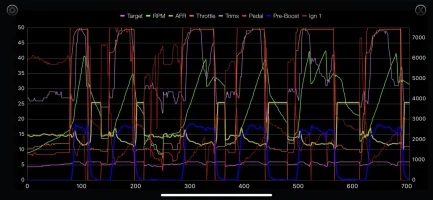

I got a JB4 not too long ago with Injen Intakes and HKS spark plugs. I run Shell 93 octane V-Power Nitro+ and just put in some Boostane Professional, after diluting it with another 3 gallons of 93, should be 98-99 octane based on Boostane’s app (accidentally dumped half a bottle of Boostane in the tank). These are my first logs on Map3. I did many pulls, the last pull I feel was the best because I had a wide open road and started from a dig and started logging right when I shifted to 3rd. My max Boost was 18.7, which I thought was a little low for Map3? Attached is the graph and logs. Any advice would be much appreciated
Set your JB4 to auto log at 80% throttle. Do a WOT run from 40 to 90 ish. Then repost.

Update your FW, it is pretty old (22). Latest stable is 27.
