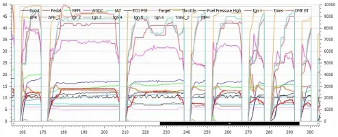

hey guys, I have a 20 GT2 AWD and installed injen intake and jb4 shortly thereafter. Stock plugs gapped at .0025 and so far so smooth. I need to take it easy running higher maps clearly so I’m going back to Map 2 for a while but I’ve been running map4 with 3 gallons E85 + 13 gallons 93.... the log here is in MAP4 with full throttle and ranges all the way up to 117mph. Can anyone please help me check the crucial details or any flaws you can see? I know it’s waay premature to be on 4 so I’ve gone back to 2-3 for a while. Any input advice is muchh appreciated so I can learn and track on my own as well, thanks guys
Not a log of full throttle here but from what I can see so far, no obvious issues spotted.

Terry this is exactly why you are notorious in the community. Thank you very much for checking out my log I really appreciate it since I’m running a map high likely and also running on re-gapped stock plugs I’ve been a little nervous. Big big thank you for looking and replying so fast, that’s beyond impressive. Do you think it’s premature to be running on MAP4 or given the log do you think it’s ok from time to time with a 20-25% e85 mix? It’s a lot of fun moving up in maps, it sure doesn’t feel the same going down lol, thank you so much Terry
