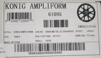

RIMS Konig Ampliform 18x8.5 +35 The color is Dark Metallic graphite. These are a Flow Formed rim. That makes them lighter and stronger than cast rims but not quite as light and expensive as traditional forged rims. They weigh 19.2 pounds each and cost $230 per rim. I purchased them through Discount Tire. One cool thing is you can use their website to select your car, it's color, and the exact rims in the color you want and see a picture of them on your car.
I did need to purchase new acorn style lug nuts which were $45 through Discount Tire. I also purchased new Kia TPMS sensors part number 52933J5000 through Amazon for $114
