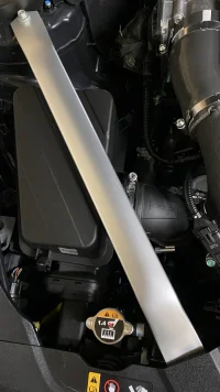

My front strut/radiator braces had what appeared to be water stains on them from new.
F7F92B50-F1B6-4781-B374-E8D02B38E1D4_1_201_a.jpeg 9F65232E-E5E0-4807-9245-CC4B9A0D901F_1_201_a.jpeg
My dealer tried to get them replaced under warranty but Kia Canada said no dice. So my dealer offered to paint them for me for free. All I had to do was take them off and drop them at the dealer and in a few days I would get them back any color I wanted. I was pretty happy about that but then my question was "is it ok to drive the car around without these bolted on?"

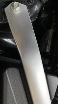

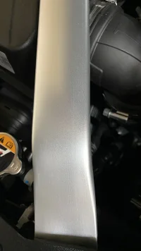

I could not get a satisfactory answer to this question from anybody and I just wasn't comfortable driving around with these things removed. So I took them off and figured I'd try to clean them myself. First I tried an SOS pad but that did nothing. Then I tried some metal polish and a little elbow grease and TA-DAH! they came out looking like new!
CFA3DF3A-7293-4F43-8613-DD0BCB8EFA58_1_201_a.jpeg 15BA45A7-73C9-4904-AE47-E6FF1D87E9F3_1_201_a.jpeg C8712E76-68F3-41EC-911B-DD6D76B6AAF9_1_201_a.jpeg
SO the answer to a question I never thought to ask is "these things are bare metal and can be polished". Problem solved for me. Although I never did find out if you can drive the car with them removed. I didn't try it and I'm not going to. Now I don't have to. If they get stained again I can polish them in a few minutes and they look like new again.

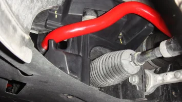

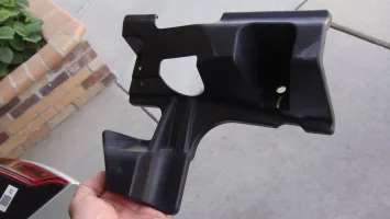

@ThunderBoy724 you rescued the thread. :D I don't intend to drive with parts missing, not even a drain plug in the battery box; not even without "covers" shielding my steering boots (the latter is on my mind because of last week DSC09376.JPG DSC09379.JPG DSC09368.JPG DSC09369.JPG ). And definitely NOT without braces!? Who would risk such a thing? (rhetorical question)
