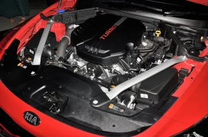

  1. Went yo my local Kia dealer today to have the oil changed. They informed me that there was a very recent Kia minor recall for my Canadian 2018 Stinger GT Limited.
    It concerned the engine oil cap, which needed to be replaced because the markings on it (type/grade of oil to be used) were wrong. They installed the new one.
    I'll try to add a picture of the new one a little later...
    EDIT Here's what the new one looks like (if I remember right, my old one had black on black markings on it, much like the one in the second picture below, which is not my from my car but found on internet):
