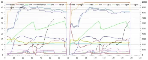

attached, i think the timing looks better yeah?
21 stinger gt, 93 octane, intakes exhaust and ark mid pipes
Fuel control wires attached? If not turn on bit0 to disable them on the software side.
Timing isn't great but there likely isn't much you can do about that unless you want to mix in some E85 or try different gas stations. It's a function of the fuel quality used.

ill try a different gas station, and enable bit0 thank you, my pnp for the fuel wires will be in tomorrow, thanks for checking it out!
