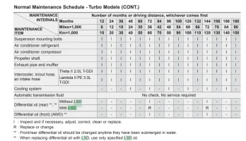

I had no noises or vibrations, my car felt like I was driving with the park brake on first thing in the morning & went away once it was “ warmed up”.
They changed the oil & this symptom went away & i have had no issue since.

Did you change the diff oil with the upgraded type as detailed on the TSB that is posted on this thread.

US owner here. Created an account just to say that I’m having this problem as well. I commute and take road trips often, so mostly highway miles on my ‘21 GT. I changed the diff oil myself just before 35k miles were on the clock about a week ago. I’ve heard 75w90 Valvoline with LSD (Limited Slip Differential) Additive is good to use so I gave it a shot. Practically the same as 75w85 the Stinger requires, but it seems the LSD (Limited Slip Differential) on these cars are more temperamental than you’d expect based on this thread. Thinking about draining and refilling with OEM fluid as it may remedy the problem, but it seems a dealer checkup may be in order despite the mixed experiences from this thread.
