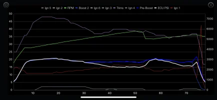

Hi everyone. I just did a revision from lozic for a more flat boost curve for the high rpm. I’ll keep you guys updated once it arrives. Currently I’m holding a 1.5 bar tune and I asked for a 1.4 bar but much linear boost curve. I was originally thinking of a revision with more timing but Canadian pump gas sucks so lozic offered me a more linear boost curve instead. It should behave similar to my current map 6 setting but I’m expecting it to be more stable and maybe even flatter than map6.
Currently map6 setting:
The best place to buy Kia Stinger modifications is at KDM Warehouse dot com! The official store of Kia Stinger dot com...

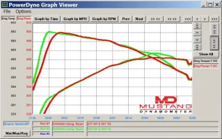

Mustang dyno.
Green is map6 with +1.7 psi at 5500 rpm comparing with map0 (+3.5 in the setting)
Red is map0.
Mods:
Injen intake.
Secondary cats and muffler gutted.
Lozic 1.5 bar ECU(post HPFP update)+TCU
Snow stage 4 WMI with 80/20mix

Mustang dyno.
Red is map0.
Mods:
Injen intake.
Fuel: Shell93 (Alberta/BC new formula)
dahm im pretty sure mustang dynos run low aswell

Mustang dyno.
Red is map0.
Mods:
Injen intake.
Is this in AWD or RWD mode?
