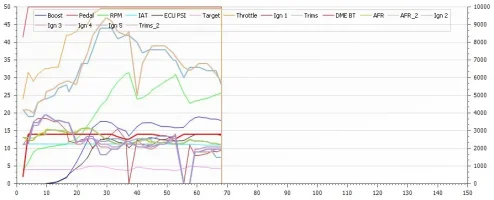

R runner1 Stinger Enthusiast Joined May 27, 2019 Messages 506 Reaction score 223 Points 43 Aug 9, 2020 #1 Did a pull today and had quite a bit of 1-2 shift burble/popping from the borla exhaust. Can anyone advise if I’m too lean from this log or what causes the Bark between shift. Log 2 91 octane. Pulled hard but just concerned Attachments P21_M2_R1_200809_1755.csv P21_M2_R1_200809_1755.csv 7.3 KB · Views: 3

T Terry@BMS Authorized Vendor Joined Jul 4, 2018 Messages 3,593 Reaction score 2,186 Points 118 Aug 9, 2020 #2 Fueling looks normal to me here, trims not maxing out, fuel pressure holding, no bank to bank variance. Attachments 080920_0805.webp 30.9 KB · Views: 9

R runner1 Stinger Enthusiast Joined May 27, 2019 Messages 506 Reaction score 223 Points 43 Aug 10, 2020 #3 Ok thanks terry, that bark on the shift though... it’s like a backfire but different, hard to explain i know
