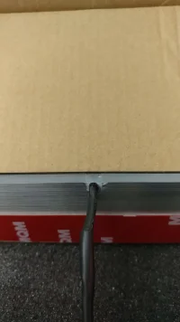

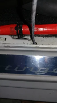

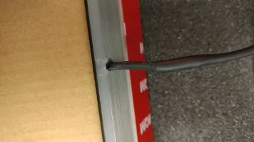

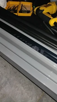

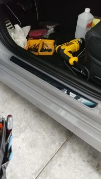

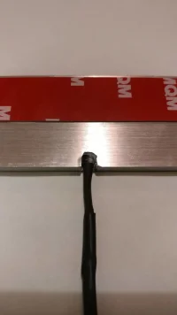

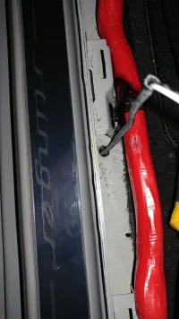

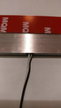

    Cape Coral, FL
    I finally had time to install these scuff plates. I was able to hide the wires. It was a bit more work, but very worth the result. I'll take you through: 0717182120.jpg 0717182126.jpg 0717182134.jpg 0717182134a.jpg 0719181825.jpg 0719181826.jpg 0719181828.jpg 0719181828a.jpg 0719182010a.jpg
    So the plates are made of acrylic so I just used a razor to score them a bit in order to pop out a small opening in the bottom rather than the side. Then I used some heatshrink and silicone to seal and clean them up. Not necessary, but I like a little extra protection. Then I drilled a hole directly under where the scuff plate cable would slide down into. And another on the inside where the cable bundle hides (pictured). I then fished the cable through the 2 holes, and there you go! Most difficult part was drilling those 2 holes, but really not a big deal.
    Hope this helps!
