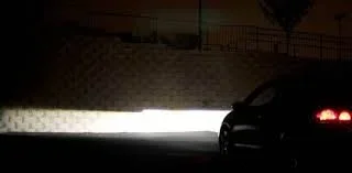

    When driving at night with LED headlights I keep getting flashed by oncoming traffic as if I had my high beams on. Is anyone else experiencing this?
    Are the headlights aimed to high up. Picture attached showing the line of where the lights meet the road and to me almost seems a little far out and wondering if the headlights are aimed a little to high. Can they even be aimed?

    As I was driving tonight I was thinking the exact opposite that they were aimed too low.
    There should be a level adjustment screw somewhere near the headlight.

    Looking at your photo I agree they appear high, I would refer this back to the dealer for adjustment/correction if required.

    I suspect there are limit stops on the range through which the computer is allowed to move the lights. No idea how the system works, however, but it might be unaware of changes in loading (weight in the rear) or if you have modded the suspension with springs. But certainly seems to need checking by the dealer.

    It's in the manual, but does not show how to adjust.
    Other KIA models have a simple gear adjustment down low on the assembly, I used a Torx driver to adjust them on my Sorento.

    Stinger have the same.
    It does not matter if manual or autoleveling.
    At the end of the lamp are two holes.
    U (two-sided-arrow) D, L (two-sided-arrow) R.
    Don't touch L and R,its fixed.
    U and D is up and down and can operated with a long cross-screwdriver.
    Set the correct hight after the autoleveling has reached the zero-position...

    It looks as if you had the high beams on. Take it to the dealer they will be able to realign them.

    Thanks for the feedback all. I will take it to dealer to have a look.

    It would be nice to see a pic of the light pattern with the car on level ground pointed at the side of a building, from around the same height as the headlights for comparison - like this:

    I mean from the OP, so we could see how his were aligned.
