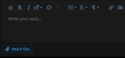

I need help trying to figure out whats going on with my 2019 kia stinger gt2. I get a knock sound in cold start then it goes away about 3 seconds after that. the car drives completely fine until arounds 2.5-2.7k rpms where the knocking comes back. i have video of cold start but dont know how to attach. Can anyone help me out?
Is this option available when you reply? Maybe because its your first post you can't. The knocking noise maybe the High Pressure fuel pump. But won't know till we hear.
