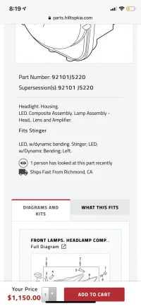

    Hello guys I’m new to post to the forums but not new to lurking and reading in the forums! I was searching around and found that the 2018 US models didn’t come with the dynamic bending headlights, but the EU models did. Correct ? Among searching around I actually found a site that sells all the Stinger headlights w/Dynamic Light Bending and the w/o Dynamic bending headlights. Do you think it could be possibly for the 2018 model years to switch the Non Dynamic to the Dynamic ones ? Thanks!

    Interesting was it only the GT2’s to get them? I have a GT1 fully loaded, I just didn’t like the shifter in the GT2. Think it would be do-able to switch the headlights to the Dynamic ones ?

    Different headlights, computer programming and sensors. You’d have an easier time swapping the shifter than the headlights.

    You don’t think it’s be as easy as switching headlights to the ones that are being sold as “with dynamic light Bending from a Kia store?

    It'll be one hell of a job. Switching headlights is one thing but there's so much more to it. New sensors, reprogram the ECU for it to work, probably rewiring everything form the steering wheel. Not worth it IMO.

    Only GT2s came with them.
    Switching to DBL headlights would require installation of quite a few sensors and also calibration.

    Do you know what sensors exactly? I’d like to see how much it’s possibly cost.

    Enough to not be worth it, trust us.
