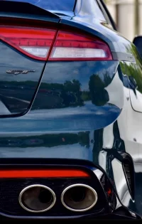

I installed a Borla S-Type on my 2022 GT1 and didn't have any issues. The exhaust tip pipes (they're not really tips) do extend into the existing "fake" tips in the rear fender, which is a little different than what other's have said here. I still think the cabin sound would be better with real tips or extensions but has anyone done it on a 2022? The tips run really close to the fender tips and I'm worried that there would be issues with heat melting the fender.
One thought was to completely remove those inserts and put real tips but I am also afraid of any heat coming from real tips could be an issue. I have some 4" OD tips that I might try but maybe someone has done something similar before I waste my time?

Have any pics of how the exhaust looks coming out the factory tips?

Sorry, I should have posted these from the beginning. It looks like one may be close to centered but the inner ones are really close to the edge.
View attachment 66757 View attachment 66758

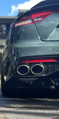

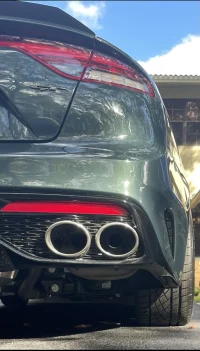

I have a 2022 as well with Borla, I just extended the Borla “tips” so they were further in the factory tips, helped reduce the drone for me where I have no issues. My exhaust shop was able to get it done were it doesn’t touch anything so don’t have to worry about anything melting. Not the greatest pictures but this is what it looked like
Ah, I see. Since the Borla tips are necked down to a small diameter, I bet I can get a 2.25" x 0.60" thick SS tube to extend them out. At least it will be a cheap way to test the sound. Thanks for the info!

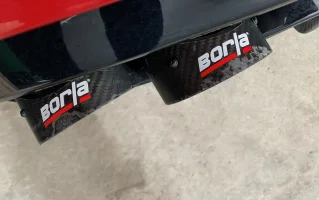

Keep those OE tips, because I got the highway-robbery Borla tips, and the inflated cost was not proportional to quality nor durability of finish...just under 2 years (2 winters) and the surfaces are visibly pitting, and a few car friends have noticed, which is embarrassing. Not good. Garbage. I don't recommend these.
Nice that they put their name on them. That way people can see who makes the pieces of:poop:
I feel for you.
The silver lining is you can refinish that clear coat yourself and restore the finish.
I’d sand as much of the clear off without getting down into the carbon then brush on multiple coats of UV resistant epoxy resin, sand and polish smooth to a gloss finish. Pretty much what you find all the carbon skinning guys are doing.
Sucks that you’d even have to consider putting work into something with such a large price tag, but worth it to salvage the part. Bonus is you can loose the borla logo, and/or inlay something custom.
As a final chemical protective measure from all the exhaust and road nastiness, you could also find a Cerakote installer to spray it clear ceramic.
