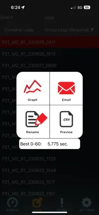

Hello fellow stinger enthusiast! Recently just installed the recommend HKS spark plugs gapped at 0.22 along with the JB4 Tuner. Now I’m not sure exactly if it’s just me but if feels almost as if the car is slower, I installed everything correctly excerpt for the fuel wires I’m waiting on the adapters to come in! My question is for the fuel wires make the much of a difference and am I seeing any power gains. Attached are two light logs from driving around town! Any help is appreciated!
Mostly part throttle runs here. For logs you'd want full throttle (pedal 100%), 40-90mph, on a safe private track.
I managed to get a 0-60 in this morning, had traction and stability control off in the pouring rain but it’s the best I can get for now! JB4 says a 5.7sec 0-60 not bad for the rain
