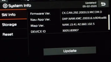

So OK, I succeeded in downloading the update once and then again. The first time was awfully slow, the indicated time was 12+ hours, but my elapsed time was more like 24 hrs. The second time on a much faster connection took 2 hours & 17 minutes from start to fiish.
Pick the fastest connection you can get, or you might run into the download crashing, repatedly, as it happened to me. After a stall the download can be restarted and the program will pick-up where it stopped, so it’s not a complete loss… To re-start, just click on the setup.exe file that was first downloaded and used to install the MnSOFT Update application. At every re-start it is looking for the order number again, which I just pasted in.
The program creates a folder and two sub-folders on the hard drive and writes to these and the SD card approximately 25GB each.
Reasonably fast 32 MB SD or micro SD cards, the latter of course in a adapter, are acceptable, a KIA branded cards is not necessary.
The version # on my download is not exactly as described in the pdf documents that come with the download, but who is to squabble at this point…
