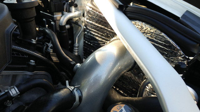

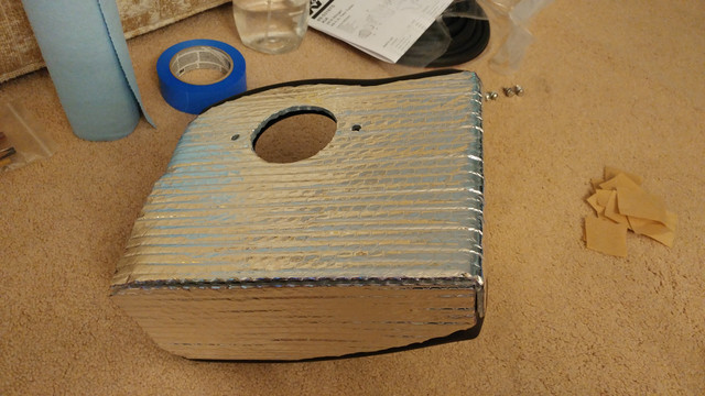

    Insulation Wrap (Bottom)
    [​IMG]

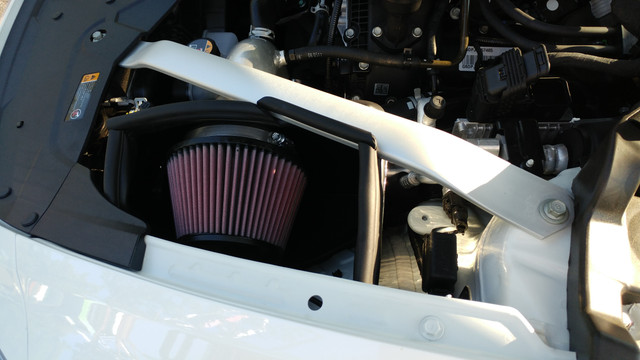

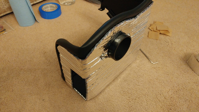

    Insulation Wrap (Complete)
    [​IMG]

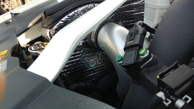

    Metallic Fleck Intake Tubing Paint
    [​IMG]

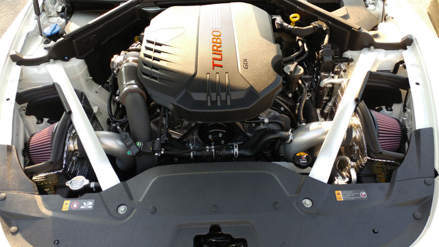

    Intakes Installed
    [​IMG]

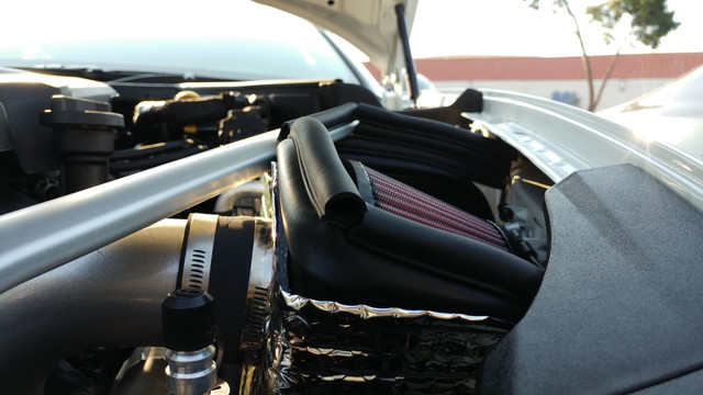

    Extended Weatherstripping - You'll notice some "indentation" on the weather stripping. This is where it meets the hood's bulge, so this DOES partially seal with the hood after all!
    [​IMG]

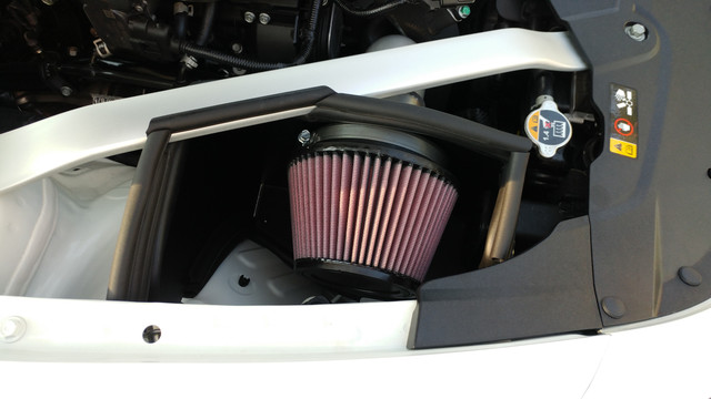

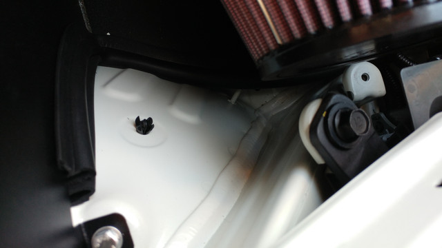

    Filling Heatshield Gaps - I placed as much weather stripping around the area to fill in gaps where hot air definitely would flow in.
    [​IMG]

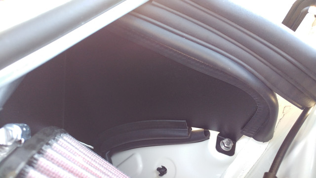

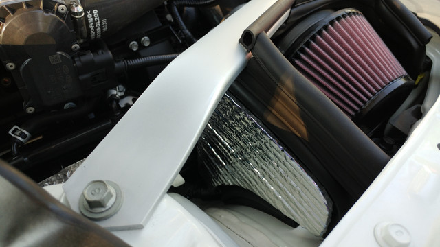

    Pic of Insulation Installed - These DO make a MASSIVE different in temperatures. When the car is sitting a long time and everything heat soaks, that can't be helped. However, even in 90+ degree weather driving 50+ miles, I can open my hood and touch the inside of the heatshield and it is ambient temperature while the other side where the insulation is has massive heat waves hitting it and the insulation itself is warmer (but obviously not hot or it wouldn't be doing it's job).
    [​IMG]

    Backside Insulation
    [​IMG]
