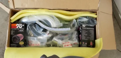

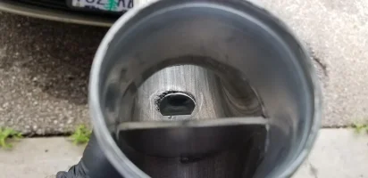

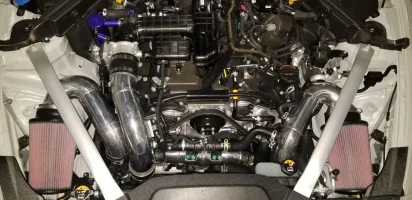

    1st for the intakes. Was straight forward thanks to his color instruction booklet he included. It was hot as crap outside installing this, so a dab of oil was needed to get the silicone to play nice. Warning- I am a QA oversight inspector for work, so I have an extreme attention to welding and fitups. None of which I mention has any effect on anything other than my own OCD. With that said, the kits were fit well and fit into the car with no real issues. I did notice some burn through on the inside, most of which was on the pressure pipe 2-1 for the cooler kit, which will not matter and is 10000% solid, however, I had to get the Dremel out and remove it.
    I ground it flush, which really, the guy welding should have done before fitting the next piece. What woulda taken him maybe 5min to do with a 90, took me a few hours with the Dremel due to bad access and angles. Again, this is no issue structurally, just an OCD thing cause its what I do for a living. One sensor mount also was threaded to a 10mm, which didn’t match the stock bolt. No issues, Home depot was 1mile away. (JT has fixed this for future kits). I polished up the pipes with some Aluminum polish and installed them. Everything went on as expected, except the driver side housing. The bottom housing panel didn’t fit and after talking with JT and taking some measurements, JT determined it was bent wrong, on accident, by an employee. (He fixed it and sent it to me at no cost). Anybody with a small toolset can do this no problem. I did not install the front intake duct work or the housing yet, cause, I want to price the cost of hacking up that plastic piece 1st and I prefer the intakes without the housing because I like the way it looks without. I didnt take much pics of intakes due to the nature of the part.
    Finished:
    Recommended tools: Socket set, 12” extension, heat gun/lube for silicone fitment, flathead screw driver, long nose pliers.

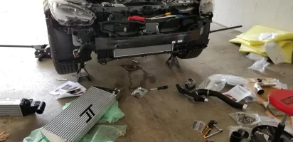

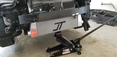

    Next is the cooler. Now keep in mind, this is maybe the 1st kit he sold and he had not made an instruction manual yet, so not only was I going into this blind. I had no idea what to do, so I started disassembling things. *Tip- Screw on old bolts/nuts/washers when you remove factory stuff. I forgot where some went o0o* The biggest issue was the cars frames are structurally different and neither I or JT were aware until it was install time. In JTs car, he has vertical crash bars installed which the US version does not.
    AUS Red car picture from JT/Another thread and US version for comparison:

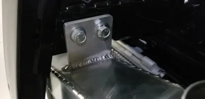

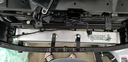

    His installer friendly IC utilized those bars to attach the cooler. Obviously, with the US not having them, I couldn’t use them or really attach the cooler properly. The IC does contain two bar type mounts which attach on the front radar bolts which held the 1st IC version with 0 issues for a few weeks, it did not move.
    Can see the bar mounts and tow hitch here with the 1st IC version
    123.jpg Next, is that damn tow hitch extension. This will need removed or grinding way down to utilize this giant IC. I 1st tried to remove it with a Dremel cause I didn’t have an angle grinder. Yea, 10 wheels later, nothing. So I bought a 4.5” grinding. It took two tiger wheels and 4 battery’s (small ones) to remove enough for a solid install. I didn’t like the feel of a cutting wheel on the angle I was using. Once that was removed and all the stock parts, it fit in no problem.

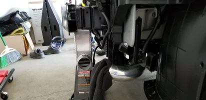

    During this time JT and I were in full contact about the IC mounts not working for the US version and he had a different version which uses tabs, but is a more complicated install. To use these tabs, you need to drill 4 holes in the crash bar and utilize nutsocks (like a threaded rivet, great thing btw, I wish I had more uses for these) to create threads to screw into.

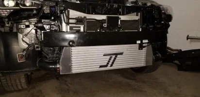

    Fitting 2nd version with tabs:

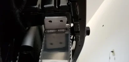

    JT shipped me another IC, at no cost to me, from the AUS to PA-USA, with all the hardware, side tab style IC, and new driver side duct work. It used 8mm bolts and the nutsock thing needed like an 11/12mm hole!! I didn’t have that size bit, so I drilled a 10 and reamed it with the Dremel some. After that, I spread some anti rust everywhere I exposed shiny metal because it was apparent Kia didn’t do a good job with the anti-rust as I saw oxidation everywhere behind the bumper (not sure I would call it active corrosion at this point). Let that dry and crimped the nutsocks. 1000% did not move 1 bit once crimped. Because it was hard for me to center punch the bracket holes, some were like 1/8th off center, so I fixed the bolt not threading correctly by reaming the bracket bolt hole on the IC from 8mm to 10mm and used a washer. Everything threaded in fine with that extra room. Used a drop of blue locktite (can be removed with heat) on the bolts and that was it. Bam. It was now secured.
    Holes drilled, Id guess 11-12mm dia.
    Nutsock things Firmly installed. Only showing 1 side cause the other is identical:
    Bam, shes not going ANYWHERE:
    Finished. The plastic vent thing will need to be heavily modified to get it to play nice with the height of the new IC.
