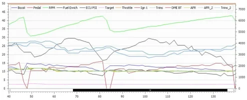

Have around 200 miles on our new development car and figured it was time to do a few baseline runs.
First up map0 (stock tuning). This was the best of a couple tries. I'm sure if I could get a more aggressive launch or on a cooler day the car would be in the 12s stock. Pretty impressive!
Boost was around 11psi with a slight taper towards redline, AFR really rich at 10:1. I suspect there is some hidden power, and maybe the root of our platforms misfire issue, in that AFR. Definitely will be working on JB4 fuel control soon. Note, the JB4 logs both banks of the engine so you can compare for differences. In this case they lined up perfectly as expected.

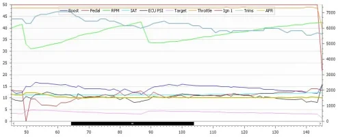

Next up for kicks I selected map4 which is a prototype "valet" map in the v3 firmware I'm testing. It runs around half of the stock boost level. Based on the 1/4 mile trap difference (108mph to 98mph) seems like it cut around 100hp!

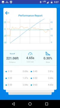

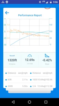

I did an obd 1/4 mile time app while at the real drag strip and the app was .3 faster than reality. Just heads up not to trust the data 100%.
Kamauxx
2500 Posts Club!
4,607
1,794
I think those screenshots are from that draggy GPS box thing.
Terry@BMS
Authorized Vendor
2,962
1,693
Yes the apps are not accurate at all. This is dragy and it's spot on: dragy - GPS Based Performance Meter - Free Shipping in USA
