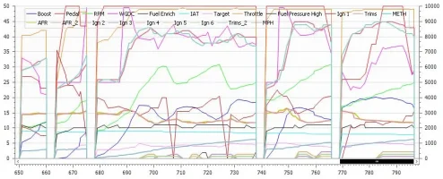

Not sure how the whole forum thing works, but I recently just updated my firmware and wanted to make sure things are right. I'm compelety new to reading all of this.... Not even sure in posting in the right place.

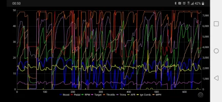

Do a few WOT logs. Cruising around at 2K doesn’t do much. So basically push the go juice peddle to the floor like your trying to put it through the floor and hold it there going through a number of gears. Do not do this in traffic or on residential streets. :thumbup:
Do you have fuel wires installed?
Set your JB to record at 80 to 90% WOT pedal, not the button push.
Short runs but I don't see any obvious issues.
