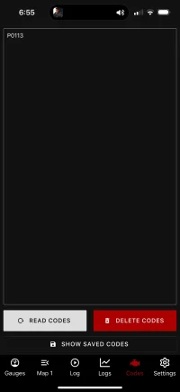

Hey everyone, hope you’re all doing well!
I just had a jb4 installed(no spark plugs yet) and also have the BMS intakes so running map1.
My car seems to get a code P0113 every once in a while and goes into limp mode a few times. The car seems to accelerate not the same as well and it’ll rev on its own(prior to CEL). I clear the code and it’ll pop up randomly. Any suggestions are greatly appreciated!
Thank you!
Shooting from the hip, it's possible you flip flopped the two connections. That code is IAT. Or, it's not seated properly.
