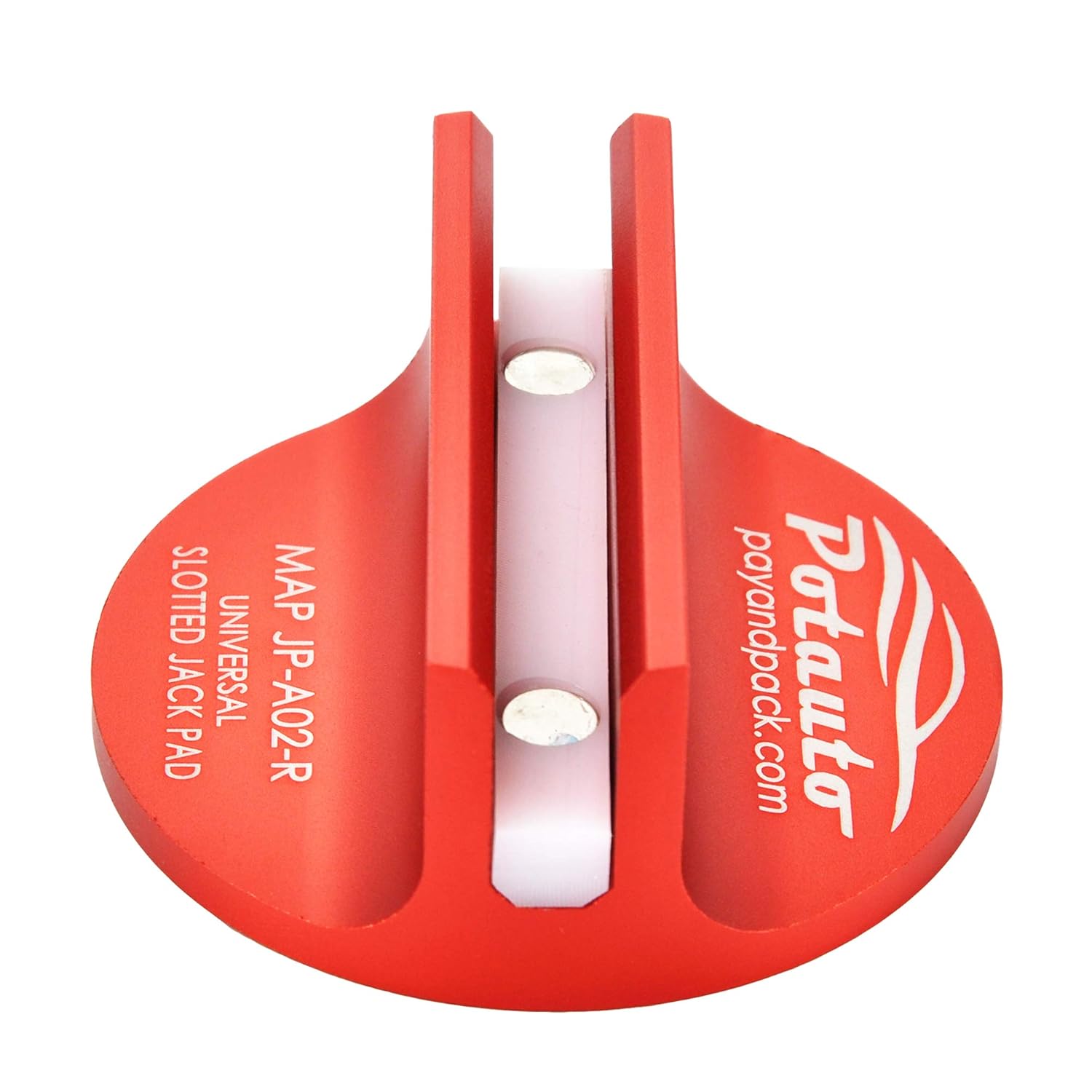

    I'm about to buy a stinger. So just so that we are being clear...
    1. Get hydraulic jack and put in a Pinch Weld Adapter to use on the rail. PICTURE
    2. Jack up car to desired height
    3. Use common jackstands at designated spots ("Plates welded to the frame with 2 tabs and a raised dot")
  10. itguy61
    itguy61 United States Stinger Enthusiast
    550
    123
    Location:
    Fort Worth , Texas
    That is what I do, although I brought the rubber pieces that insert in the jack-stand as well. Another option is to use the sub frame down under the front end but you have to remove the rear covers down there first.

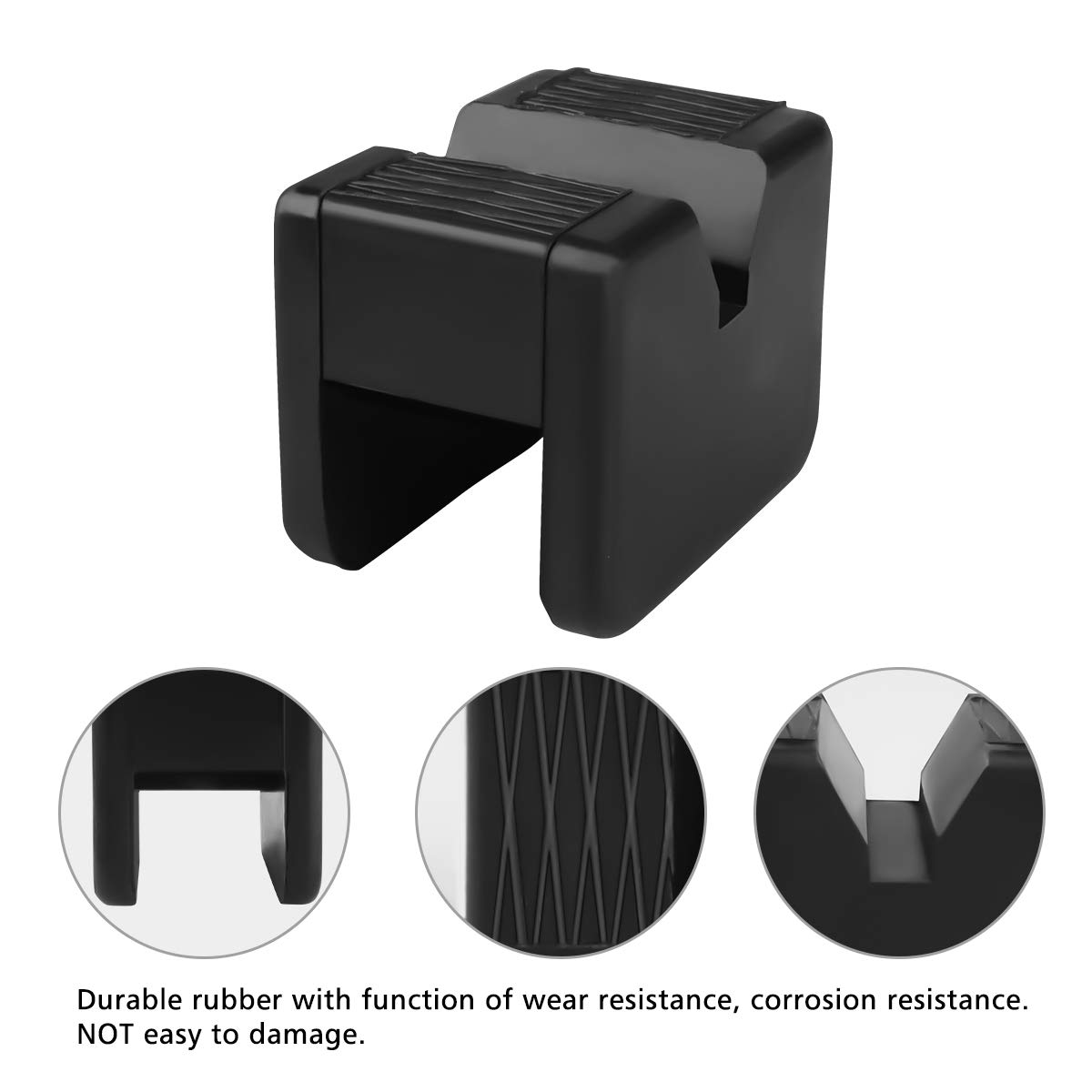

    What rubber pieces insert into the jackstand?
  12. itguy61
    550
    123
    Location:
    Fort Worth , Texas
    you can buy them on amazon, ebay and others. they have the slot in them just like the rubber for the floor jack. Keeps jack stands from damaging those points.
  13. Rev_Night
    Rev_Night United States Member
    52
    7
    Something like this? LINK
    [​IMG]
  14. itguy61
    550
    123
    Location:
    Fort Worth , Texas
    yep they work pretty good keep you from boogering up the jack point with the metal stands.
  15. Rev_Night
    52
    7
    aight, thanks for the help man. I'll be sure to buy these jack and jack stand adapters
