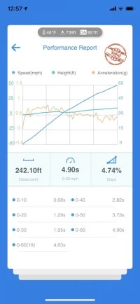

I can tell a small difference at speed; it’s not huge, but it’s noticeable. Car pulls more smoothly and enthusiastically when I mash the go button above about 30. I’ll post a screenshot of my best 0-60 here, but my technique is probably where I’ll get the most gains there (not to mention, I didn’t unload the family gear from the car before running it). I did not have the JB4 enabled for that run.
