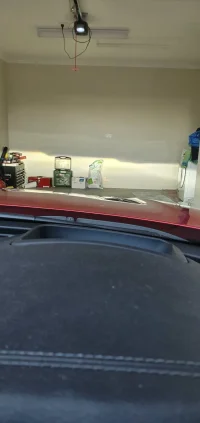

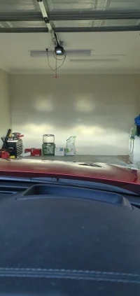

    Hi all,
    I've noticed an issue with my high beams that they tend to light up alot of area higher above where they should. On a road with overhanging trees etc, you're pretty well blinding the possums with the high beams. It's not the direct light, but seems like a reflection or something as it's not as bright as the direct high beams.
    I've attached two photos, one of the low beam which is fine. The other of high beams where you see the normal high beam horizon, but also two round spots halfway up the wall. This is maybe 5m away in my garage, so as you can expect they point very high when on a road. Has anyone see this? ? 20190821_170508.jpg 20190821_170456.jpg

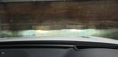

    Can't say I had noticed, but I don't do a lot of night driving and haven't had cause to use high beam. Here's how mine looks as of a few minutes ago.

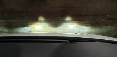

    Looks like that's just how they are. I've got a photo below a bit closer and looks like a similar pattern to yours. Seems rather strange that it's a design element to be like that. I do a bit of night driving on back roads and notice it quite a bit. Doesn't seem like many people notice it so guess I'll have to just put up with it!

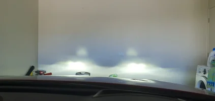

    This is mine at approx. 5-6 metres off the wall in my carpark at work.

    They are known as "squirrel finders", it's 100% normal.
    The Stinger high beams have them, quite badly. They are designed to light up highway signs off in the distance so you can read them (the huge signs, that tell you exits and highway intersections). You can block them off, but it requires you to open the headlight and block the plates off.

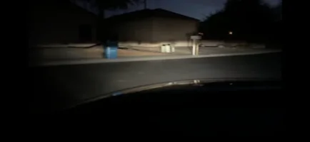

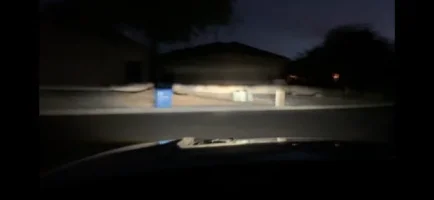

    No, I reaimmed the cutoff to match my Mazda and took some photos last night to highlight the difference. As you can see, the Mazda's light is way more uniform, way wider, brighter (hard to match the exposure using my phone), illuminates more directly in front of the car and has less glare (note the reflections and horizontal lines of light above the "cutoff" especially on the Stinger, midway up the house).

    The Stinger's lights are brighter. The dark band in front of the hood isn't an issue since that light is wasted (too close) to do any good at driving speed. But you did say there is a discrepancy between the pics and what you really see. To me the shape of the lighted areas is of less concern than the amount of light; specifically how far out it reaches.
