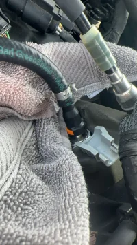

I'm trying to get this dang flex fuel line off the car to replace it with the stock one, but its not coming off as easy as the stock one did. I tried pushing the orange part with a metal pry tool but it still isnt moving. I don't know what I need to use or do.

Hey bud... once you have bled the fuel pressure out of the fuel line push the hose down and press the orange clip inwards and voila it should release with a minimum of spillage.
Pull a fuse i guess and crank the engine till it doesn't start is my suggestion.
