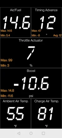

I've been teaching myself how to read and interpret the various information from the OBD2 port. I'm not familiar with reading Timing Advance and I haven't found much information on it.
Is there a certain range I should look for? What's considered bad or good? I've had 0 knock or rough engine operation issues. Any insight is appreciated.
What are you using to see that info? seems like you have most other BMS products, getting a JB4 and selling that racechip would not only make you more power but also allow you to log properly.
I'm using the Car Scanner Pro app plus my BAFX Bluetooth OBD2 Scanner/Reader. That's a screenshot of the dashboard I made so it's not showing everything. Sxth Element is developing a new piggyback and releasing it soon Q1 next year so I'll be going to their shop which is about 50mins from where I live and installing and then Dyno before and after.
