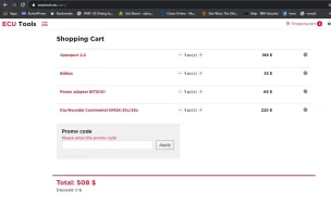

Hey guys! As promised on my live videos here's all the hardware you need to flash your ecu at home! The price has went up a little bit
But for those of your who don't want to ship your Ecu's here you go! for ~600$ you can. At some point I may rent out my gear
to others but thats going to be months away as I'm beta testing atm.
The Frame for placing pins 40$
LED BDM Frame with Mesh 4 Probe Pens for KESS KTAG K-TAG ECU Programmer Tool | eBay
Openport 2.0 189$
Openport 2.0
BitBox
BitBox
On this site you need to get all the items listed below to be able to flash your ecu.
Ecu you want to support:
Kia/Hyundai Continental SIM2K-25x/26x
FID 152 220$
USB Security Dongle for bitbox (must be bought with ECU support)
Dongle 33$
Power adapter BITS001
BITS001 66$
