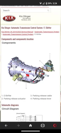

    Has anyone or does anyone know if I can swap the GT2 shifter + electronic parking button to a shifter like the Gt1 model. I cant stand the parking button nor do I like the fact that I cant manually shift into manual mode, gt2 shift mode is activated by the paddle shifters and than deactivates if no shift happens after 60 seconds, super annoying. I rather like the standard PRND shifters

    Its definitely not going to be as simple as just changing the handle out. The entire system is electronic in the gt2 compared to the manual mechanism in the other trims.

    The GT1 has a mechanical linkage b/w the shifter and the transmission. The GT2 has actuators/servos directly bolted to the transmission, which are controlled by an electronic control system which receives input from the shifter.
    If you ripped out the servos and shifter, you could probably rig up a mechanical solution, but I doubt the other control systems would allow the vehicle to operate without the appropriate electrical signals.
    You'd be better off trading in your GT2 for a GT or GT1..
