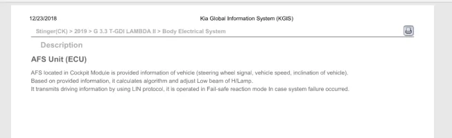

    Mach_Tuck United States 1000 Posts Club!
    1,029

  18. OliverNuther
    OliverNuther Australia 1000 Posts Club!
    1,076
    283
    88
    Location:
    Brisbane, Australia
    I know you’ve got it in writing but I can’t say that I’ve found that to be true. My headlights always throw shorter than I would prefer. There is a section of undulating road that I drive every morning in the dark at about 80 KMH and I’ve not noticed the headlights throwing longer or shorter as my speed varies or as my car inclines upwards or down. I know how to adjust the headlight levels and I’ll do it one day but my general impression is that the lights throw short.
