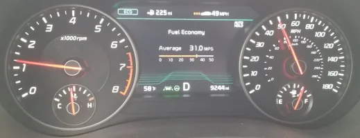

  20. Karl Davlin
    Karl Davlin United States Member
    41
    29
    Location:
    Missouri
    GT2 AWD w/no mods cruising mostly at 75MPH with a nice tailwind... Just got of the highway and snapped a picture. So, actual mileage is probably around 29MPG. By contrast, my last fill-up was only 23.77MPG (actual) with about 80% highway.
