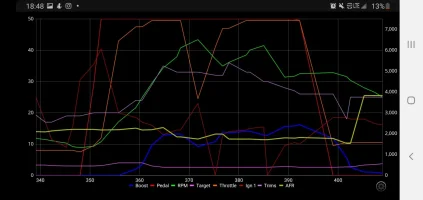

Hoping someone could take a quick look to ensure everything seems in order for these logs. Just installed, regapped OEM plugs for now until I purchase an intake. Sorry for the single log, i didnt realize combine logs was automatically enabled. Fuel wires and OBDII installed
This throttle down spike seems odd, didnt noticed any power hiccups when running it. Also don't know much about reading logs, but i noticed it only happened once and after looking over other peoples logs I dont noticed the same thing on theirs

Seems fine to me so far. RPM dipped down there so you're shifting or less off the gas, or DSC kicked in.

Probably let off the gas honestly, coming from an EVO X with the DCT it became engrained to let off when it shifts otherwise it'd be a rough shift and smack me or my passenger around. Still getting used to the stinger. Thank you so much Terry for the quick response
