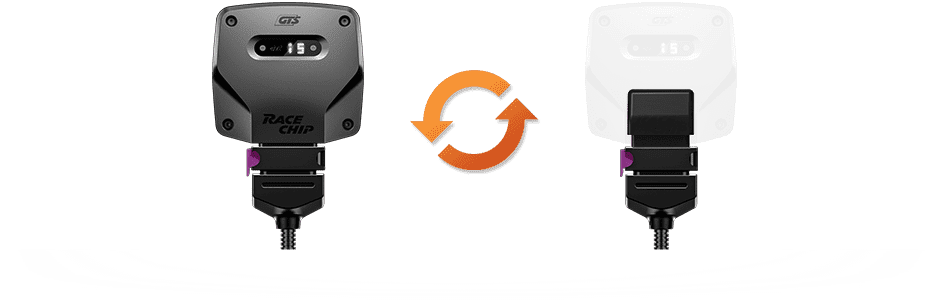

2) The newly connected plugs are not oriented correctly
The original plug can be wrongly attached to the connector housing of the delivered wiring harness (meaning one of the plugs is turned 180 degrees out of the correct position) . In this case a contact cannot emerge. This might cause error messages and / or prevent the engine from starting. Please find the correct orientation below.
Plug A and B:
Plug C:
