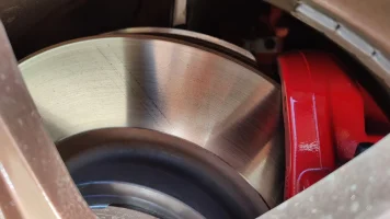

last time I was at the track I was using super aggressive GLoc pads with stock rotors. Of course i didn't understand quite how difficult the bed in process was with aggressive pads. you basically have to devote your first session to it. couple warm up laps, a few laps more aggressive, then a couple full cooldown laps. Of course i tried to bed them in before I went to the track and essentially had no pad transfer to the rotors. as a result, my first session left uneven deposits and the next two days resulted in even more uneven deposits and brake shudder the whole time.
In a month I will go back for a couple of days, with DBA T3 rotors and hawk hps 5.0 pads. The brakes are properly bedded, or close, with even deposits around the rotor surface. I'm expecting better results this go around.
