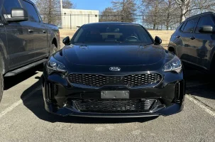

Hello everyone,
I bought a 2020 Stinger GT2 with 23k miles, which came with K&N cold air intakes installed. A few weeks ago, I had a concerning experience after accelerating aggressively in Sport mode, where the check engine light turned on and I felt a slight vibration. However, after turning off the car and restarting it, the vibration and check engine light disappeared, so I didn't think much of it at the time. Unfortunately, the same issue occurred again a week ago, but this time the check engine light stayed on after restarting the car, even though the vibration was gone.
I took my car to AutoZone, and they diagnosed a cylinder 6 misfire, recommending an ignition coil repair. I tried fixing it myself by purchasing an OEM Kia ignition coil and installing it on cylinder 6, but the problem remained. Since the car is still under warranty, I am considering taking it to Kia for repair, although I am concerned it may take a while to fix.
Can anyone help me figure out what's going on? Why can't my Stinger handle heavy load in Sport mode? Is cylinder 6 the closest to the passenger seat?
Thanks for any help you can provide!
