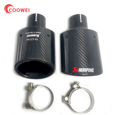

Make sure you get exhaust tips that fill in the gap in the rear fake exhaust tips. You will need to remove the fake exhaust rings. They are kinda a pain to remove.
The ones I use are these below. Make sure they are 63mm inlet and 130mm outlet. They fit pretty snug but do a good job of having sound exit outside of the rear bumper. You do not need to get them welded on. Just clamp them on properly. Give it 3 weeks to get the tips. The glossy colored ones look great.
