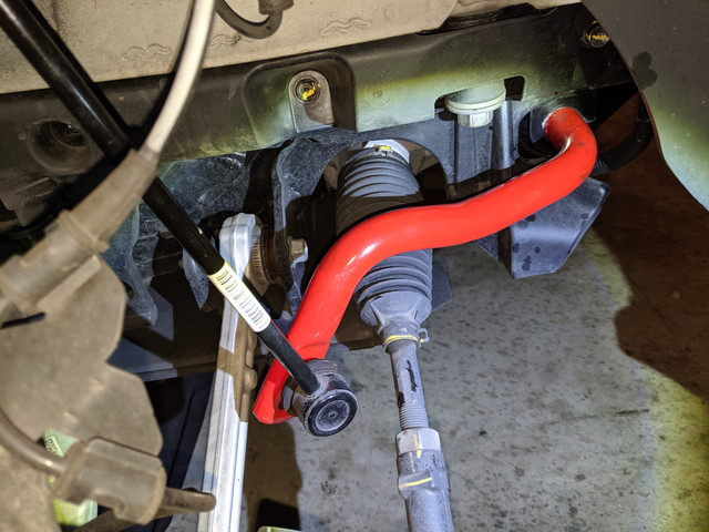

Front Swaybar on Firm:

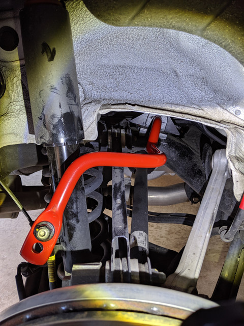

Rear Swaybar Bracket:
Rear swaybar on Firm and Centered Bracket View:
That last pic brings me to the most important thing I noticed about these swaybars. The Eibach bracket holes are slotted which allows the bracket and thus swaybar to actually be mounted in slightly different positions which can affect preload of the swaybar and/or difference in handling characters between left and right turns. I took the time to make sure that the bolt (and thus bracket) was perfectly centered in the slots on both swaybars, but there's a full inch of play. That play was enough for me to slide the bar around and see how it changes the angle of the endlink and thus could affect the load angle. Since both are free to slide around, it's possible to have a full inch forward on one side, and a full inch backward on the other which in my fiddling sat the bar crooked across the vehicle rather than straight across. This concerns me greatly: I think Eibach engineers didn't want to take the time to ensure bracket precision and just used general slots to minimize fitment issues figuring most people won't notice the difference anyway. Leading into my final thoughts on them is another point of contention: the factory swaybars actually lock into the brackets, thus resisting rotation of the swaybar. The Eibachs are free to rotate. This has a bearing on suspension bounce when both wheels go up and down together: the factory one actually slightly dampens this motion while the Eibachs do not.
So how does it feel you ask? Absolutely great. Not only does it tighten up road feel and handling response, but also firms up the ride over mildly bumpy roads. I almost regret having ordered it as part of a "kit" (I'm putting in sport springs this weekend, so stay tuned on that, too!) as I feel people who just want a slightly firmer ride and better cornering need only order the Eibach swaybars, put them on firm, et voila. I live near a very winding road, and I could easily push another 5 MPH on the tight, blind curves without even feeling like I found the limit, yet. I could even ease into the gas a little, hinting at oversteer but instead letting me accelerate through the S curves. This hinted that it had even more room in it than before to go a little faster! But all isn't perfect. I've noticed an increased "shimmy" behavior when going over speed bumps at a slight angle, or that steep driveways can no longer be "rushed" as the car basically feels like it's getting popped up into the air side-to-side. I now have to go over speed bumps and steep driveways slower than before because the car has become less compliant. This could be mitigated by setting the bars on "soft", but that would probably defeat the purpose and eliminate the firmer ride afforded by the firm setting. Additionally, I went into a driveway that was a bit too steep at my usual speed, and my head hit the B pillar because the car basically got rocked like a cradle :lipsaresealed: I believe that the factory swaybars add a bit of mild but constant dampening due to their locked position, and this explains why there's a sort of "pop up" with the Eibachs when going over anything steep before the dampers can properly dampen the motion.
Oh my, this is directly addressing the earlier discussion about "fixed" sway bars not working like sway bars are supposed to. So you have confirmed that the OE rear bar is "fixed". And this makes me return to my theory that Kia designed the handling around a "fudge" of what a genuine sway bar usually does, by using a less heavy bar but made stiffer "artificially" by locking it in place. It works (for most people).
But this does pose the question: why rear end "bounce" would be resisted more by the locked design of the OE sway bar; while everyone who replaces it with the rotating Eibach asserts (groupthink subjective reasoning?) that it makes the rear end more "planted" and eliminates or greatly reduces the "bounce/float" of the OE setup.
