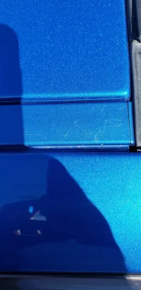

    Looking for some opinions here. I've searched the forum and I do not find anything that lines up with the same problem I'm having. I have a 2018 HiChroma Red. As you can see in the pictures the paint on the drip rails is cracking/crazing. Initially I thought that the dealer did not remove the protective vinyl was not removed by the dealer. Before I do anything does anyone know what is causing this? IMG_20191013_134644.jpg

    Look at posts #2801 and #2820 in the above discussion for examples. It is a fairly common issue. Most likely a combination of paint/clearcoat defect on these plastic pieces which have then succumbed to UV exposure. I've seen it on other cars as well, but not typically on vehicles that are so new.
    Simply take it back to a Kia dealer and get them to replace the pieces.

    I have a 2018 GT Ceramic Silver. Roof rails are doing the same thing. Paint cracking very prematurely. For all the hype associated with this car. Paint should not be an issue

    My dealer has been trying to figure out how to fix this for the past 5 weeks.
    They have new strips from Kia, but they're only provided in black. They have a rubber-like surface, so the body shop refused to paint it. Supposedly the service tech is trying to get info from Kia on how they are supposed to be prepped and painted.......

    Why not wrap them? If they went crazed once they'll likely do it again. So try some other approach.
