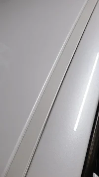

Maybe I’m seeing things, but today after owning the car since 2/2020 I walked by it and noticed the drip rails on both sides are an off white compared to the rest of the car.
If you look at the car from an angle from the rear to the front you can see the difference in color, but front to back looks fine.
The color even outside of my garage on a sunny day looks different the the Snow White Pearl color of the car.

Yep, a known issue with some. It is probably the beginning of the crazed paint that results in cracks. These are quick to remove and replace under warranty. Sorry that your drip rails are going south on you. :(

But the Stinger's drip rails are "rubber coated" steel. @rocket23 stripped his, buffed them bright and sealed the bare steel with either ceramic or clear coat, I don't remember which. That looks really good on a Silky Silver; and I think it would look good on a White or Ceramic Silver too.

Possibly, but both rails are showing zero signs of cracking and the off-white color seems to be consistent on both sides.

It's not unusual to see variations where the same colour is applied to different surfaces.
Here's my 2018.

here's a pic of mine after the strip an clear coat...incidently they pry right off, just take care when /if you decide to remove and do what I did.....I used a wire wheel on a table grinder....came out decent.

Pearl white finishes are notorious for appearing differently on sheet metal vs. other surfaces such as plastic bumpers. In this case, your rubber coated drip rails. Here's an article that helps explain why. So I would say nothing to worry about... perfectly normal.
