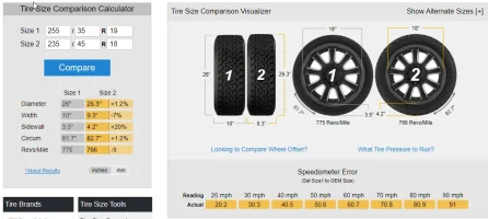

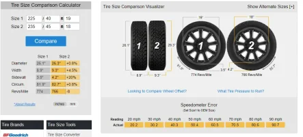

I was looking to get winter tires for my GT for a road trip through the north and winter driving, as part of this I was looking to increase the sidewall as much as I could and move to a symmetrical setup for more economical tire rotation and treadwear warranty. Figured it's overdue to write up what I did and how it turned out. I know people love big wheels with super low profile, but I'm fatigued of that and was looking for a larger more aggressive looking wheel and sick of the sacrifices super low profile comes with, I also didn't want to change the gearing or speedo characteristics. So downsizing to 18s and upsizing the sidewall was the way I wanted to go.

I settled on 235 / 45 R18 98V XL Michelin Pilot Sport A/S 3+ , as these tires are all the "Winter" performance you need in North Carolina, cold mornings with no snow to contend with. The A/S 3's are not the kind of all seasons that can deal with real snow and ice, but they don't lose traction on cold mornings like the OEM PS4s.

So far I'm loving how it feels, the ride is noticeably quieter and smoother with 20% more sidewall, I have 7% less contact surface in the rear, and slightly 4.5% more in the front, but RPMs and Speedometer is a near perfect match (1MPH off at 90MPH). And I really love how it looks, It's summer now and I still can't bring myself to switch back to the OEM setup. Total cost was $1500
