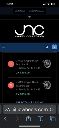

Hey everyone. I am looking for a set of dished wheels for my car. I came across a set of JNC 005. The set up is 19x8.5 et 30 and 19x9.5 et 35. I am wondering about fitment / poke with the dish. Will they work with the Brembos. Any suggestions would be appreciated. Car is not lowered. Thanks.

I had to learn about ET offsets the hard way, but even when I got all the numbers right, I still had a set of spokes hit the calipers when the spokes were too thick/deep. They were 18" rims, and a set of 5mm spacers fixed it but I HATE dealing with spacers.
Your specs look good, but I would double check the depth of the spokes because the brembos require more clearance than most.
It's more than just the width and offset.
You can have a wit and offset that work, and the spokes can still hit. It depends on the shape of the side profile of the spokes. The shape is not typically dimensioned, so you sometimes have to do a physical fitment to see if they fit or not.
Knowing the offset, is not enough to know with certainty if they will clear the calipers or not
