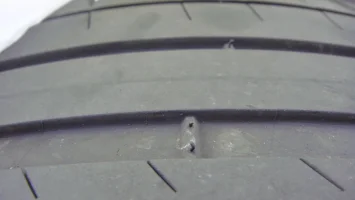

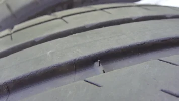

    I’m baffled right now and very disappointed with my OEM Michelin tires. I only have 8k miles on them and my left rear tire is literally falling apart.:mad: There are multiple chunks of rubber all over the tire that keeps coming off while driving.
    1679B73B-2D6E-410A-9256-C6FA33AE6CB5.jpeg 857DFB86-AD97-4F21-97D2-716F121DF062.jpeg 299F9AB2-3311-4BF6-BC20-F15C105C7519.jpeg
    Worst part...Kia service won’t replace them since there is NO warranty on new vehicle tires.:confused: They claim it’s normal wear & tear from the soft rubber in the Michelins and simply need to be replaced.
    Unless I’m mistaken I still see the “wear warning” marks in the treads and they seem like they have plenty of miles left in them. I feel like Kia is trying to take advantage of me, but I’ve already talked to two managers and they still won’t cover them.
    I’ve had dozens of different “high performance” tires on many of my cars and never had this problem. Is this a defective tire? Is this something worth fighting Kia over to replace? Or should I believe Kia and just blame the Michelin’s for POS tires that fall apart in under a year...:unsure:
    Any suggestions or advice will be greatly appreciated.:thumbup:

    Sounds like you should call Michelin they maybe aware of this previously? It's worth the call. Explain that Kia couldn't give a rat's arse.

    That doesn't look like normal wear/tear to me...
    I would contact Michelin and see what they can do.

    no car manufacturer warranties tires, unless you buy that road hazard warranty, you'll have to contact Michelin. I've seen damage like that before, it was on a GTR during a track day, he slid off and hit the rumble strips sideways. I'm not saying it's your fault, but there are things people can do to cause this type of damage. It's usually a combination of lost traction and a rough surface. Considering it's the back tire, the PS4 is quite soft, and you're in a hot part of the country, that all increases the likelihood. It could have been something as simple as accelerating over some shallow potholes, your back tires lose traction for just a second, and the pavement knocks chunks of rubber off. Hard cornering and donuts could also be the cause, this type of tire damage is VERY common among drifters.

    Definitely a compound issue. I see that you are also suffering form the premature wear on the center of the tire.
    Contact Michelin directly and they will be able to help you.

    Can't tell from the angle of the pics but to me it looks like they are at the wear limits - those bars in the grooves are near the surface of the rest of the tread? I agree with everything above about imperfect road surfaces..
    Anyway, the tire manufacturer warranties the tires, these are for 15k miles on a staggered setup, so you should get a hefty discount on a new set as long as you work through an authorized Michelin dealer.
    I don't expect to get more than 6-8k out of mine. If you drive this car the way it was intended, you're going to shred these tires long before the advertised mileage.

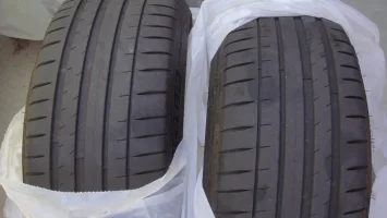

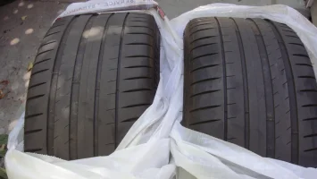

    I've been posting these pics a lot lately! Those are my Michelins at 10K miles. The Big O test showed the fronts "almost like new" and the rears are at 80%. I'm thinking that only two explanations are going to work here (and not mutually exclusive either): you are a "spirited" driver and hard on tires; and/or the tires you have are flawed. I agree with the above: go directly to Michelin with this and get that prorate! :thumbup:

    Thanks for the input and I did already reach out to Michelin.
    Unfortunately they confirmed there is no “tread-wear” warranty and the best they could do would be to give a prorated credit based on wear. However that credit would only be valid on another Michelin tire, and I would have to pay full retail price from their dealer~$600+:cautious:
    That’s like going out to eat at a restaurant, finding a bug in your food and them only offering 20% off your next order.:confused: I wouldn’t want their disappointing food again, so a discount off buying their inferior product again is just insulting...
    Also I didn’t measure mine but agree they are worn almost to the “wear marks” so any credit I would receive would be minimal and not worth going that route. And unless they were replacing them for free, I would never get those POS tires again...

    I don’t corner hard or drift, and never have done donuts in my Stinger... However, my local roads are all patched up and have lost traction under mild acceleration before. Also, I had a defective rear differential that was serviced multiple times before it was replaced. It would push more power to one wheel and would easily lose traction all the time, especially over any bumps. Even the service mananger said the LSD (Limited Slip Differential) could be a factor on uneven tire wear & loss of traction. That seems like even more of a reason that defective OEM parts contributed to the excessive & unusual wear.
    With that said I’ve lived in the same area for 20+yrs with multiple cars & multiple high performance tires and never had this problem. Bottom line, $300 Michelin’s shouldn’t have these issues and the fact that Kia or Michelin isn’t stepping up to make their customers happy is simply disappointing.:thumbdown:
    Lol. No offense but those tires don’t have 10k miles on them. They still have the new tire “hairs” on them...:cautious: They come off after a few hundred miles, not thousands.
    I understand you’re making a point but providing misleading info isn’t helping me or anyone.:unsure:
    I don’t deny I drive the car how it was designed...as a high performance GT. But I’m not abusing it and never had similar issues on any other high performance car or tire I’ve owned. A defective tire makes the most sense, but nobody wants to make it right so now I’m forced to buy new tires in less than a year.:thumbdown:
    Don’t get me wrong I still love my Stinger, and know new models are prone to issues. It’s just disappointing having so many issues in less than a year, and now Kia’s refusal to resolve a customer issue is making it really hard to keep recommending them. Just not what I expected from a $50k high performance GT thats trying to compete with Audi, BMW & MB...:unsure:

    LOL! Back at you, sir. I have the tires to show anybody. And I replaced them with Nitto Motivo UHP A/S on 28 September. I currently have 15,219 miles on my car. This pic was taken on the 21st Instant.
    I am a "spirited" driver only in spurts or dashes. The rest of the time (I am sure 99% of the time) I drive like my daddy, like a grandpa.:D

    Those remaining "hairs" are only on the wear bars that sit well below the actual tread. Merlin had those OEM tires on for ~10k miles before switching for winter.
    I doubt I'll get 7k out of mine before being totally worn, but not everyone drives like me..
