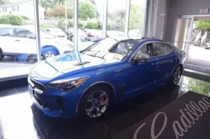

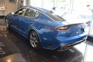

I have a 2018 Stinger that has 12,000 miles on it. It has been into the dealership 4 times in the last month for dead battery issues. The last time it was in for a week. The morning after I picked it up it was dead. (this morning) I bought it used with 6,000 miles on it. I found out the last owner had it in the dealership (in another town) for 3 months, they apparently could not solve it so he traded it in on a Cadillac and I got stuck with it. I am gong to look into the lemon law and try to get my money back or sue Kia.
This isn't yours by any chance? ;)
