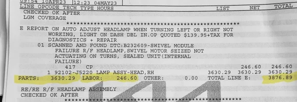

Year make model mileage, warranty status?, what are we working with here?
Do you have either code DTC:
  • B232509
  • B232609
If you are outside of warranty, follow the attached.
Mine was within my extended warranty (mileage at the time was 113k KMS), so the lazy Kia dealer just replaced my whole headlight assembly rather than replacing the desiccant and bracket.
Only $3,876.89 for this specific warranty claim... (I paid only $2,601 for the extended warranty)
