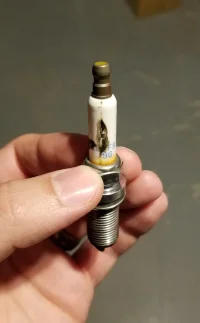

    Yeh it misfired under load because as boost builds the combustion gets hotter heating the plug core and expanding the porcelain open an shorting. If short is detected for more than 5 seconds, or something along those lines, the engine shuts down that cylinder by cutting power to the coil. Exactly what had happened to me, it drove normal for the past 2 weeks it has had a blown plug just couldn't get on the gas at all if I want to accelerate... Prius driver's were fed up lol.

    Shutdown cylinder and restart to normal definitely sounds like blown plug, exact sumpsymp I had, have a look at the plug, torque for it is 30nm (don't recall how much that is in ft/lb but wrenches all specify both NM and ft/lb, torque for the coil bolt is only 11nm so don't push too much on that one.

    Bingo Bango Bongo! Look at that Sparky all banged up.
    Appreciate the help! Car runs like a top. Question is will the IKH24s hold up...
