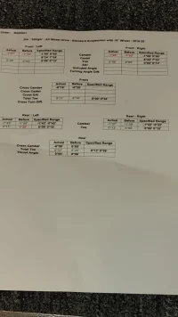

For those in the know. Are these alignment specs ok? I'm on ARK lowered springs so I expected camber to be out of spec some. Despite me telling shop guy that my trim is a RWD, I see the computer chose the AWD specs. Not sure if that really make that much of a difference?

-1 degree on camber is pretty tipical for lowering springs on the stinger not ideal ,just purchased rear upper adjustable camber arms and considering a coilover for the front so I can adjust camber wait and see how my tires wear

That is not a crazy amount of camber. Assuming you keep the toe correct it shouldn't cause the tires to have a half-life or anything. I've run on springs on my last 5 cars and always had over -1 camber front and rear. It's great for handling!
