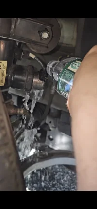

Eventually I took a water bottle and poured water on every connector and drove around the block 2 times for each one.. it wasn't until I poured water onto the actuator on the strut that the light finally appeared. I waited for the car to dry once more and the problem to go away to make sure this was the culprit... Drove around town and no light... Pulled over and poured water onto the actuator.. "Check ECS"
Somehow, this actuator is allowing water to leak and cause a short. It remains like this until the water has fully dried out. I genuinely don't know how this is possible, but it goes to service in 3 more days. Every Kia service center doesn't want to hear my diagnosis and my discovery and they still want to charge me $200 to diagnose the issue that I already found, and I know for sure they won't find it because they don't know it's water related. I just hope that when it finally goes into service, they will listen to what I discovered and fix it under warranty.
