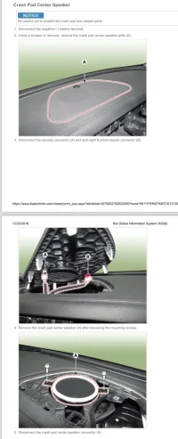

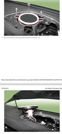

Has anyone removed the center dash speaker cover ? I want to run a wire for a radar I need to get the cover off. tryed to pry it up on the edge of it was not successful don't want to screw up my dash just wondering if anybody else had success?
Can’t really help beyond giving you the KGIS scans so you can see where the tabs are. Interior removal pieces would help.
Ok Thanks that helps looks like I just need to pry harder a bit difficult because the dash is a soft material but those tabs should release
