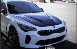

    Stock _ 38 lbs
    Adro $1500-2400, Korean, real vents, rain guards, weight 18 lbs
    Seibon OEM $735-900, US, real vents but not air flow more radient, rain channels, 19.5 lbs
    Seibon TS $835-$1000, US, real vents, no rain guards, ? lbs
    Strictly Business Motor sports OEM, $1135-1350, US, fake vents, 26 lbs
    SBGT, $1135-1350, US, real vents, rain guards, 26 lbs
    SB M $1135-1350, US, real vents, ? , ?
    Ark Legato $1200-1400, US, real vents, ?, ?
    Element6, $2000-2500, Korean, real vents, rain guards, 14.7 lbs
    Adro
    Seibon OEM
    Seibon TS
    SB OEM
    SBGT
    SB - M
    Ark Legato
    Element6

    I don't think the more angular hoods really work on the Stinger. Adro first by a long shot then Seibon oem and SBGT tight second for looks. We need Kharz or K8 to stock a dozen Adro and get the shipping price down ($900).

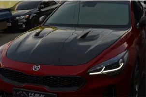

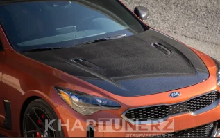

    Does anyone have pictures of Seibon's OEM hood rain channels? How does it work and where does it drop the water?
  15. Tonkabob
    Tonkabob United States 2500 Posts Club!
    2,587
    1,223
    Location:
    Seattle, Wa
    The vents lead into the support channels and water would come out the larger oval I'm told. Not sure if the oval comes out or is porous.
    This seems more like radiant cooling than airflow. The owner said he does see heat waves comming out the vent.
