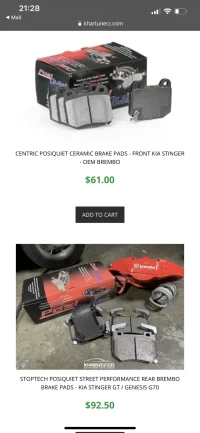

what is really the difference between these 2 , having the infamous braking problems ?!!

Ultimately, if rebedding (as described by @DoctorStiches) does not solve the problem, you will need to either have your OE rotors resurfaced, or replace them: in either case, get new pads, and aftermarket is the fix (no risk of this occurring again with OE pads). Both of those that you show have been used to correct the "shakeys".
